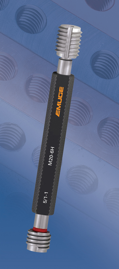

Emuge Thread Gages inspect the pitch diameter and functional thread for internal-threaded components. Being fixed limit gages, Emuge Thread Gages provide a GO/NO-GO status of the internal threaded hole.
A recessed minor thread diameter is featured on the NO-GO side, and a dirt flute is provided on the GO side, to eliminate gage/thread damage in demanding environments. The GO and NO-GO sides are each mounted on the one gage handle. Gage handles are knurled for maximum gripping ability and safety.
Each handle is clearly identified with the size and Emuge identification number for traceability and ample space is also provided for custom laser marking requirements, a service which is available. The NO-GO side is clearly marked with a red ring.
