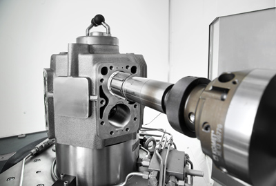

Deployed on a 4-axis machining center, Heller’s NCU out-facing head prepared for honing can adjust the size, taper, surface and tolerance of a bore as it changes the size of the tool during the honing process. A Marposs in-process gage is incorporated into the head.
Heller collaborated with DIAHON to program honing cycles that permit helical slide honing. The H series are able to create a continuous cross-grind that can otherwise be produced only on advanced, expensive honing machines.
Unlike on honing machines, however, bores with a cylinder form tolerance of just 1 µm can be produced in one setup over a length of 300mm, for example, eliminating the typical 3-pass honing process and minimizing honing cycle time.

But according to Bernd Sihling, honing can be extremely process-capable and controllable: “Honing isn’t such a complex process. There are three distinctly different types: honing by means of a permanently set tool with a defined diameter, honing by means of a tool with a flexible diameter, the hone of which can be expanded by coolant pressure, and path-controlled honing on machining centers, as accomplished by Heller with its controllable out-facing head.”
Heller has added honing to the smart technology mix on the H series machining centers. The advantage is that this 4-axis machining center is highly dynamic and has a U-axis (out-facing head).
While economical, honing on a machining center must also satisfy technical requirements, including the highly precise replication of macroforms (cylinders). Series con-rod machining using coolant- expanded honing technology has also been performed on machining centers for some years now, but not at production volumes.
Honing of coated cylinder crankcases by means of out-facing heads combined with a non-wearing air measuring between nozzles and bore during honing is expected to become a preferred solution in engine construction for the future. High productivity is complemented by high precision (tolerance less than 6 µm) with specified surface finish, roughness, plateau structures, and cross-grind.
