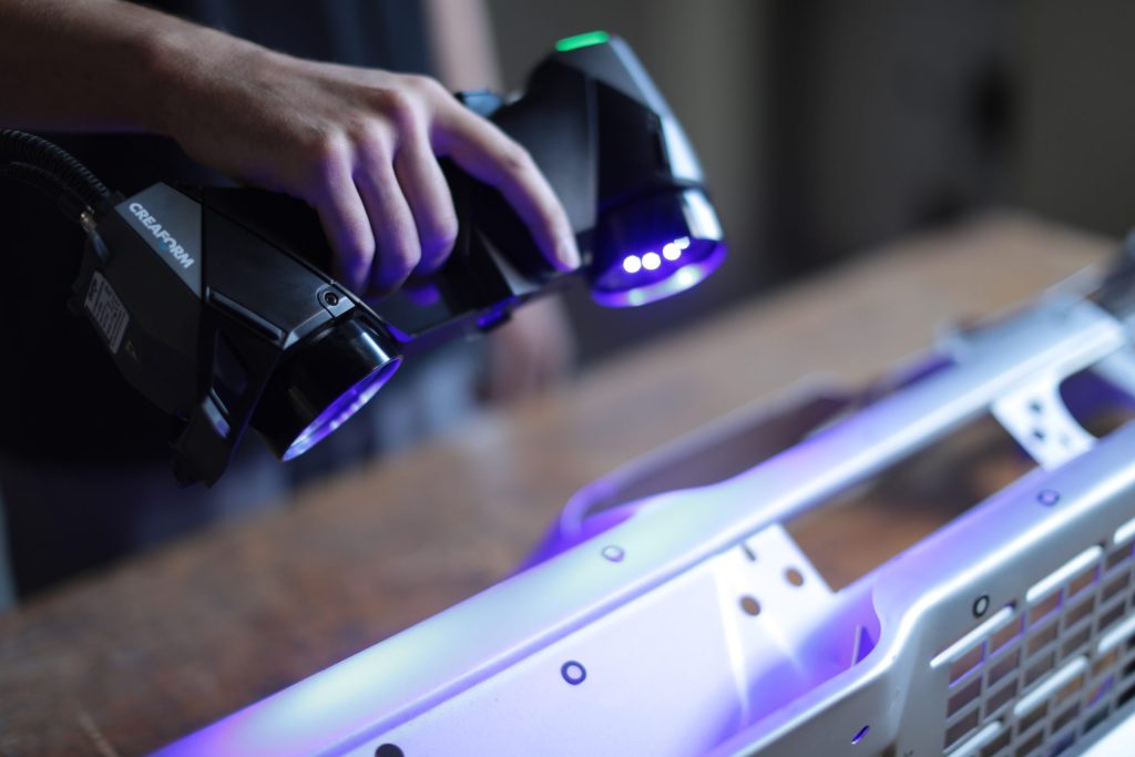

Creaform launched a thoroughly reengineered and refined update to the HandySCAN 3D: the HandySCAN BLACK. This is the third-generation version of Creaform’s patented metrology-grade scanner. Its launch marks more than 15 years of innovation of technology to meet the evolving needs of the manufacturing and engineering industries. The HandySCAN BLACK is made for professionals who need the most effective and reliable tool on the market to capture accurate dimensional measurements of physical objects.
HandySCAN BLACK combines high-performance 3D scanning with improved optics, multiple blue laser technology and a sleek, ergonomic design. Its distinctive simplicity and portability advantages are a staple of Creaform’s product line. As the company’s flagship portable metrology-grade 3D scanner, the HandySCAN BLACK sets the standard for measurement, regardless of size, material or complexity, within seconds anywhere.
High-Performance Tools to Meet Rising Quality Standards:
· 4X resolution: Captures fine details and large volumes thanks to the unique and versatile combination of improved high-performance optics and multiple blue laser technology.
· 3X faster measurement speed and instant mesh: Larger scanning area featuring 11 blue laser crosses that take up to 1,300,000 measurements per second, ultimately cutting down the time between acquisition and workable files.
· More accurate and traceable measurements:Volumetric accuracy of 0.020 mm + 0.040 mm/m (0.0008 in. + 0.0005 in./ft) based on VDI/VDE 2634 part 3 as well as ISO 17025, ensuring reliability and full traceability to international standards.
