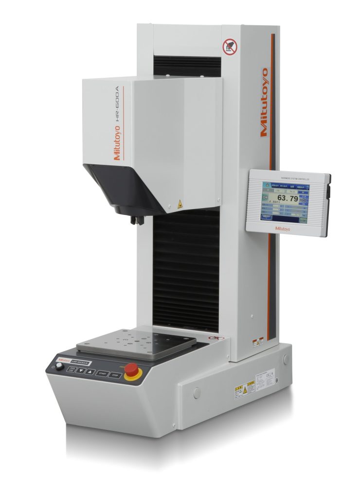

Mitutoyo America Corp. announces the release of the HR-600 hardness tester into its line of precision measuring instruments. The HR-600 series combines functionality for Rockwell hardness testing and for Light Force Brinell testing in a single machine, expanding the range of available measurements.
Key features:
- HR-600 is the first Mitutoyo hardness tester to be equipped with a moving head. The head moves at a speed of 10 mm/sec. within a 210 mm range.
- Table for mounting workpieces and head with vertical mobility.
- Tables are bigger and have more depth, allowing large workpieces to be mounted and measured as-is. Maximum load limit: 100 kg; Depth (from indenter center): 220 mm.
- HR-600 Series can test a wide variety of workpieces, ranging from metal (crankshafts, cylinder blocks) to softer workpieces (brake pads, plastic parts), and supports both Rockwell and Light Force Brinell hardness testing on a single machine.
- Touch-enabled screens enable users to directly view results. Users can choose from five different displays [standard operating, simple, multi-point test, list display (mean value) and list display (five-point display) based on various views]. Users can directly select the hardness scale of their choice, and statistical analysis features can analyze multiple test results, streamlining the workflow and reducing measurement and analysis time.
- AVPAK software enables smooth and efficient measurements. AVPAK, using part programs, enables automated multi-point testing in the X-, Y- and Z-axis directions.
- The HR-600 supports special testing and offers supplemental add-ons, including PCs for remote operation software and V-anvils for round workpieces.
- The HR-620 Type B tester with AVPAK can be combined with the Mitutoyo Form Eio software and a PLC to create a system that coordinates with robots, users can automate the testing procedure, from mounting workpieces to sorting them according to test results.
