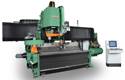

Capable of drilling, scribing, countersinking, tapping, milling, oxy-fuel and plasma cutting, the HSFDB-C is changing the way the world processes plate with its latest features including:
A unique bevel torch that is the only beveling system available on a true CNC plate processor. With the ability to feed material to the operating area of the machine as opposed to bringing the operating area of the machine to the material, the HSFDB-C benefits its users with less material handling, lower scrap due to tighter nesting, and a smaller footprint. The optional bevel cutting assembly maintains a single bevel cutting design for both the oxy-fuel and plasma cutting torch.
A SignoMat hard stamp part marking system of the HSFBD-C utilizes a single disc with 36 different characters for part numbering or layout requirements. The innovative design rotates 360 degrees to accommodate mirrored nesting. This allows any part to be oriented properly within a nest to yield the lowest amount of scrap possible.
A 12-station rotary tool changer that eliminates the need to manually change tooling during production. The efficient design of the HSFDB-C accompanies the spindle throughout the entire range of motion to ensure that no time is wasted when a new tool must be retrieved. Each drilling unit is immediately available as needed upon program command.
Using the latest technology, the HSFDB-C processes plate up to 4″ (100mm) thick and is available in 6 ft. (1.8 M), 8 ft. (2.5 M) and 10 ft. (3.2 M) widths.
