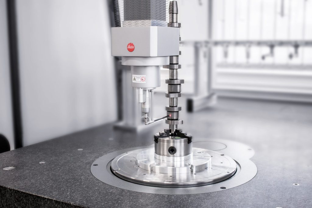

Based on Hexagon’s patented HP-O optical interferometric sensor technology, HTA solutions provide fast, accurate, noncontact scanning and dramatic time reductions when measuring complex parts such as blisks, gears, camshafts, splines, synchro rings and clutch baskets, according to the company. The sensor range includes six configurations for the right combination of inspection methods and part accessibility for the targeted application.
The expanded HTA solutions offering follows the release of the Global Advantage HTA platform for aeroengine blade measurement. This inspection application utilizes the HP-O Multi-sensor to accurately verify blade characteristics including aerofoil, platform, root, shroud and other features. The new HTA solutions include an HP-O range sensor and a high-performance coordinate measuring machine (CMM) with rotary table for four-axis scanning, as well as the advanced QUINDOS metrology software. The HTA’s combination of high-speed scanning and rapid data delivery help meet the demanding productivity goals of manufacturers in automotive, aerospace and other industries.
