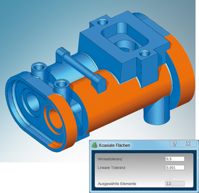

• Coaxial faces
• Coplanar faces
• Optimised chain selection
“Smart selector technology enables the simple, combined selection of surface areas and curves. Users can now select and use the required milling areas for hyperMILL much faster,” explains Wolfgang Weiss.
