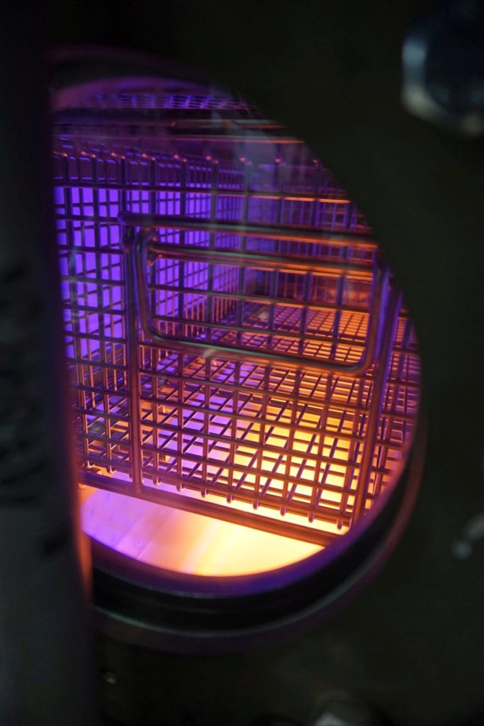

For workpieces made of steel, aluminum, glass, ceramics and some other materials that are cleaned in batch processes – whether in bulk or arranged in part carriers – the company has developed a combination cleaning technique merging wet chemical cleaning with a subsequent plasma cleaning step. To this end, a low-pressure plasma cleaning operation is integrated into the wet chemical cleaning line. Since virtually all components needed for this cleaning technology – e.g., vacuum, measuring and control equipment – are already in place in the manufacturer's wet chemical cleaning machines, the additional cost and engineering effort remains modest. The advantages of the integrated plasma cleaning process in ultra-fine degreasing are substantial, on the other hand, including a high operating flexibility, reduced process times, low investment and operating costs, plus very compact equipment build.
Cleaning is initially performed as usual by a solvent-based wet process, followed by vacuum drying of all workpieces. The work chamber is then rinsed and its internal pressure is reduced to less than 1 millibar, whereupon the process gas (e.g., filtered ambient air or oxygen) is introduced and the plasma is ignited. Due to excitation by the process gas, a plasma of high-energy ions and free electrons – plus other reactive particles – is thereby formed in the vacuum. Contaminants on the part surface, such as grease or oil residue, are chemically attacked and transformed into volatile compounds. At the same time, the plasma's UV radiation likewise exercises a cleaning effect, e.g., by breaking down long-chain hydrocarbons. The gaseous decomposition products of the plasma treatment are extracted from the work chamber by suction. Thanks to the combination wet-process and plasma cleaning operation, the free surface energy that is key to achieving an optimum adhesion strength can be raised to 50 to 80 mN/m in one single process step.
