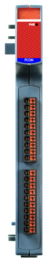

Trio is also releasing the P362 Power Connect module which enables fast, simple integration of sensors, relays and output devices. The module simplifies connection of three-wire sensors into the I/O system and removes the footprint and cost required for additional terminals. With two banks of 10 x 24 V and 0 V connectors, easy wiring and multiple connection options make installation quicker and simpler.
Both the Power Connect and Thermocouple I/O slices feature push-fit wire connections into a cage clamp. Increasing connection security, particularly for applications which could be subject to vibration, the cage clamp system improves reliability and also means faster, simpler wiring without the requirement to use additional tools for installation and maintenance.
