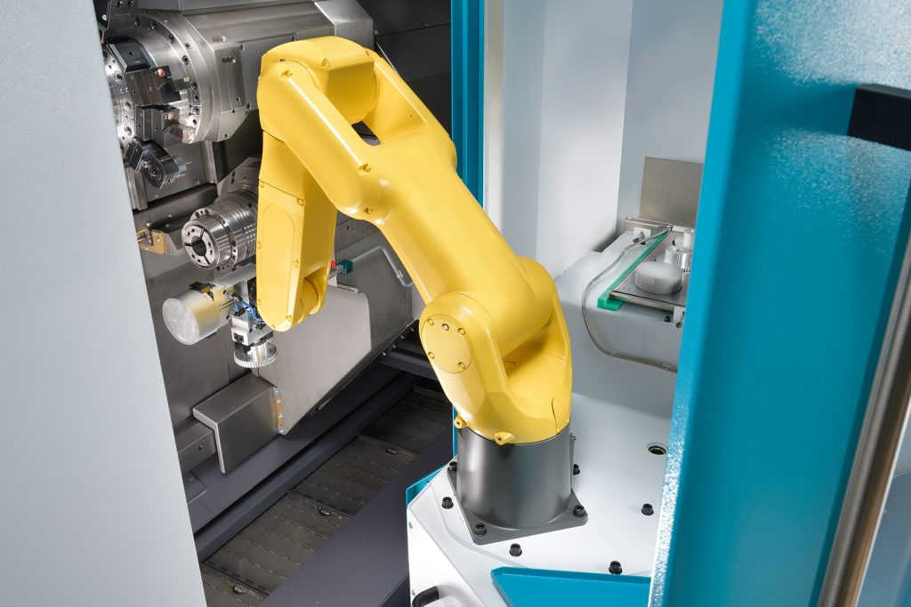

iXcenter features a space-saving vertical storage system with up to 22 stacked pallets measuring 600 mm x 400 mm. Pallets are loaded with blanks at the top of the system, while pallets with finished parts can be removed at the bottom. Loading and unloading can take place at any time with no interruption to production. Downstream processes such as cleaning, measuring, deburring and more can also be integrated directly into the cell. The system’s 6-axis robot can handle materials and parts to a maximum weight of 6 kg.
