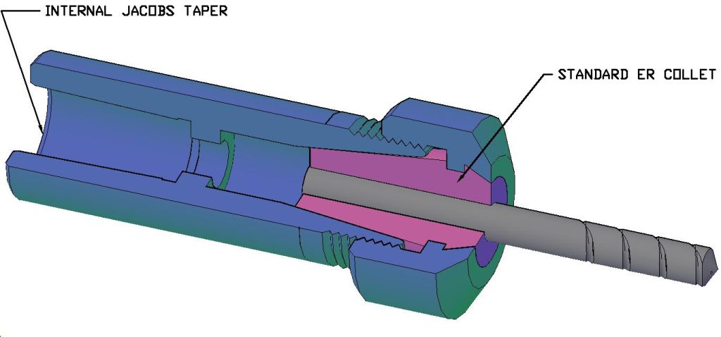

T.M. Smith Tool adds Jacobs taper rigid ER collet chucks to its family of Jacobs taper tooling. The new durable collet chucks are manufactured from premium grade, through-hardened steel.
July 10, 2018
The Jacobs taper and ER collet pockets are precision ground to provide TIR of 0.0002″ or better. The T.M. Smith Tool says its ER collets chucks are superior to keyed and keyless drill chucks in concentricity and holding power.
Available with a Jacobs taper #1, #2, #33 and #4 (JIFFY), these holders are primarily used in drilling applications. They are compatible with standard Jacobs taper spindles and accept standard ER collets. The chucks are available in an ER16, ER20 and ER32 option. Specials are always available to meet customer-specific needs. ER collets are ordered separately.
