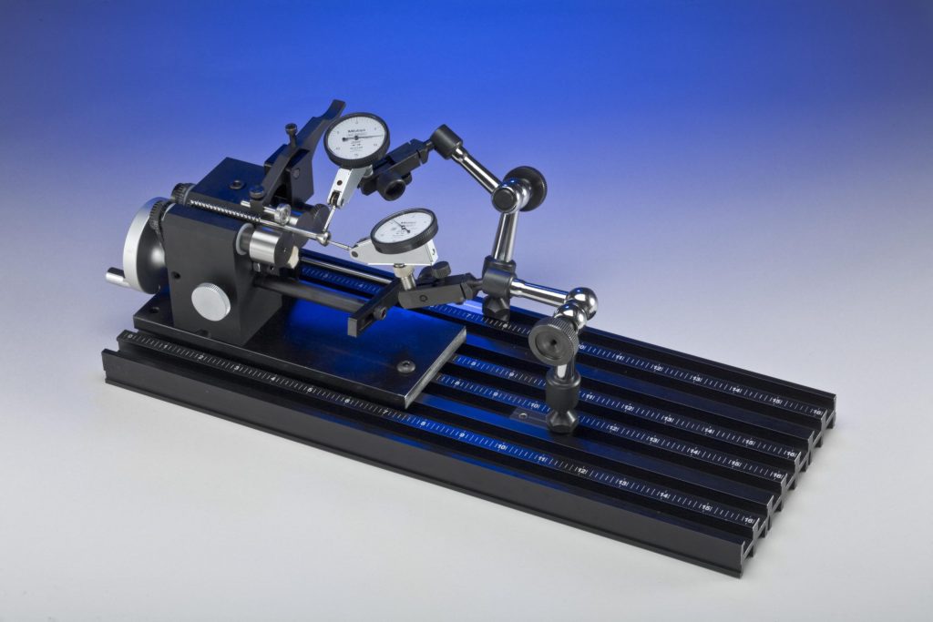

Johnson Gage offers the JCR runout and concentricity inspection system for verification of cylindrical runout. The JCR can be used stand-alone or with an optical comparator for verification of geometries in cutting tool product.
August 25, 2016
Johnson Gage offers the JCR runout and concentricity inspection system for verification of cylindrical runout. The JCR can be used stand-alone or with an optical comparator for verification of geometries in cutting tool product. The JCR incorporates precision datum rolls, a unique upper tension roll assembly, and integral axial stop pins to assure proper part staging and absolute gage accuracy.
In addition, the company offers a thread inspection system for the verification and in-process control of reverse-angle buttress threads commonly used in anti-splaying medical devices such as orthopedic implants.
