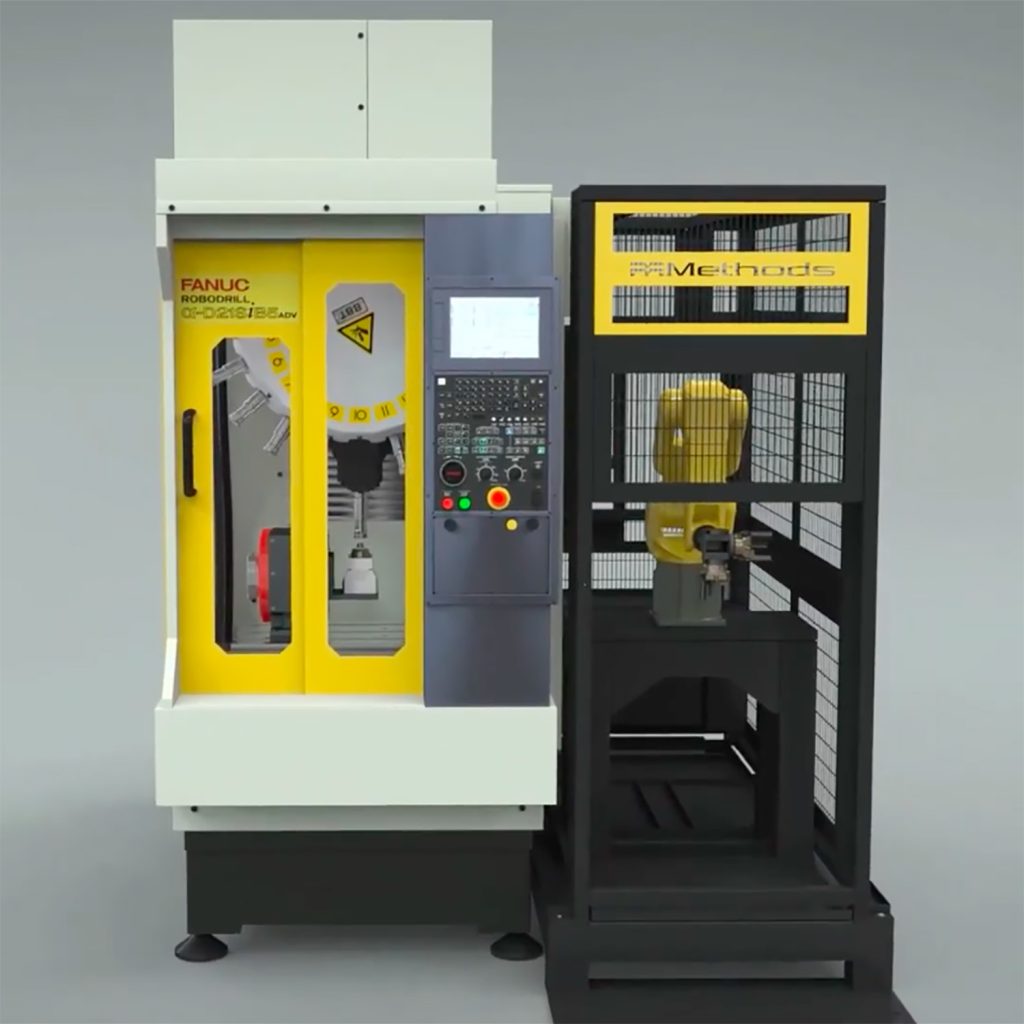

JobShop Cell PRO features an industrial grade, articulating FANUC 6-axis robot in a versatile aluminum enclosure which allows the RoboDrill to be placed on the left or right side, or in a twin cell with two machines. In the twin cell, two side-by-side RoboDrill machines with a FANUC robot entering from the side of each machine gives operators full, open access to the front of the RoboDrills for tool changes, off-sets and maintenance.

JobShop Cell PRO features an industrial grade, articulating FANUC 6-axis robot in a versatile aluminum enclosure which allows the RoboDrill to be placed on the left or right side, or in a twin cell with two machines. In the twin cell, two side-by-side RoboDrill machines with a FANUC robot entering from the side of each machine gives operators full, open access to the front of the RoboDrills for tool changes, off-sets and maintenance. Removable panels on the common enclosure allow for several different infeed and outfeed options including conveyors, drawers, lazy susan style pallet systems, as well as interfaces for vibratory and other bulk feeding solutions.
The Compact, High Speed RoboDrill D21SiBadv offers multi-axis simultaneous machining with a 10,000 or 24,000 RPM BBT-30 spindle. Customers may choose from a 3, 4 or 5-Axis configured RoboDrill, and an array of standard hydraulic or pneumatic workholding options. The RoboDrill features 1.3 second chip-to-chip tool change and 1.5g acceleration/ deceleration. A powerful FANUC 31i-B5 Nano CNC controller provides extremely fast FSSB high-speed processing.
