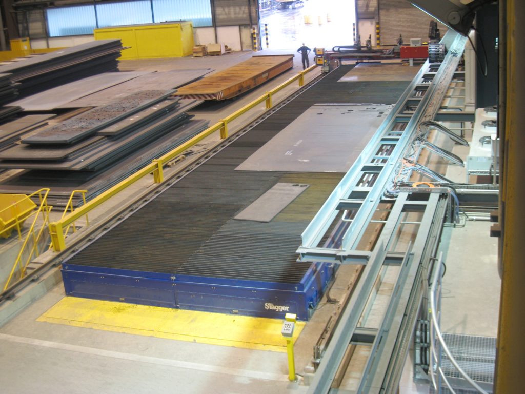

The integrated discharge system of KEMPER TheSlagger is crucial for reducing machine downtime. For normal extraction tables, companies have to dismantle the material support and remove the integrated slag containers from the cutting table in order to empty and clean them. This costs a lot of time, sometimes even several days.
With KEMPER TheSlagger, this work is no longer necessary. The patented discharge system moves along underneath the material support with a rack and pinion drive across the entire length of the table. This means that it collects slag and small parts before the shield. At the end of the table, the system discharges this directly into a stand-alonecontainer, which can be emptied while the cutting processes continue. This process only takes a few minutes, which means that the plant is quickly back in operation for the cutting processes.
KEMPER TheSlagger also meets the requirements for effective cutting dust extraction thanks to its extraction technology. During the cutting processes, the system captures large quantities of cutting dust directly at the source. As it is divided into individual segments, the system only extracts dust in those places where the cutting is actually taking place – and not along the entire table. This keeps the capacity needed for the extraction process comparatively low and energy costs are reduced compared to conventional systems.
Thanks to effective extraction, metal workers benefit from a high level of occupational safety: first of all, because hazardous substances do not contaminate the ambient air and secondly, because employees no longer come into contact with hazardous substances when cleaning. Fine dust no longer settles on nearby machinery, which means that the extraction system also contributes to the service life of the machines.
