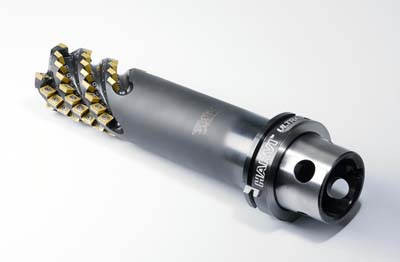

Kennametal’s response to this traditionally weak point has been the proven KM recognized by the International Organization for Standardization (ISO) as an ISO standard: ISO 26622. Now Kennametal is introducing its next-generation spindle connection, KM4X. Some systems may be able to transmit considerable amount of torque, but cutting forces also generate bending moments that will exceed the interface’s limits before torque limits are exceeded. The combination of the KM4X system’s high clamping force and controlled interference levels lead to a robust connection, extremely high stiffness, and restrained bending moment for greatly improved performance in titanium machining.
KM4X engineering results in three times the bending moment resistant capacity compared to other tool systems. This means shops can use their high-performance machining centers to increase speeds and feeds in difficult machining applications, thus gaining the full potential from the machine tool. Moreover, the ability to retrofit KM4X to an existing machine tool offers the added advantage of increasing throughput without having to invest in expensive additional capital equipment. The tool-spindle interface must withstand high loads and yet maintain its rigidity. In most cases it will determine how much material can be removed on a given operation until tool deflection is too high or the onset of chatter is reached.

It becomes obvious in end-milling applications, where projection lengths are typically greater, the limiting factor is the spindle interface’s bending capacity. As an example, an indexable helical cutter with 250mm (9.84″) projection from spindle face, 80mm (3.15″) in diameter generates 4620 Nm (3407.5 ft. lbs.) of bending moment and less than 900 Nm (663.8 ft. lbs.) of torque. The most critical parameters of a taper-face spindle connection are the clamping force and radial interference. Maximizing clamping force and selecting appropriate values of interference can further improve connection rigidity.
