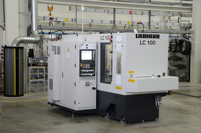

The Liebherr LC 100 is designed to machine small, mass-produced components and conventional automatic gearbox applications, such as planetary and sun gears.
"With a rapid machine loading and unloading capability, the Liebherr LC 100 can achieve chip-to-chip times of three seconds, impressive for a machine with only one work table and still meet gear quality requirements," reports Dr.-Ing. Oliver Winkel, head of application technology at Liebherr-Verzahntechnik GmbH.
The Liebherr LC 100 is designed to machine small, mass-produced components and conventional automatic gearbox applications, such as planetary and sun gears. The fast swivel loader assures short chip-to-chip times and therefore high productivity. Set-up flexibility is enhanced by exchangeable quick-change gripper inserts requiring no tools.
