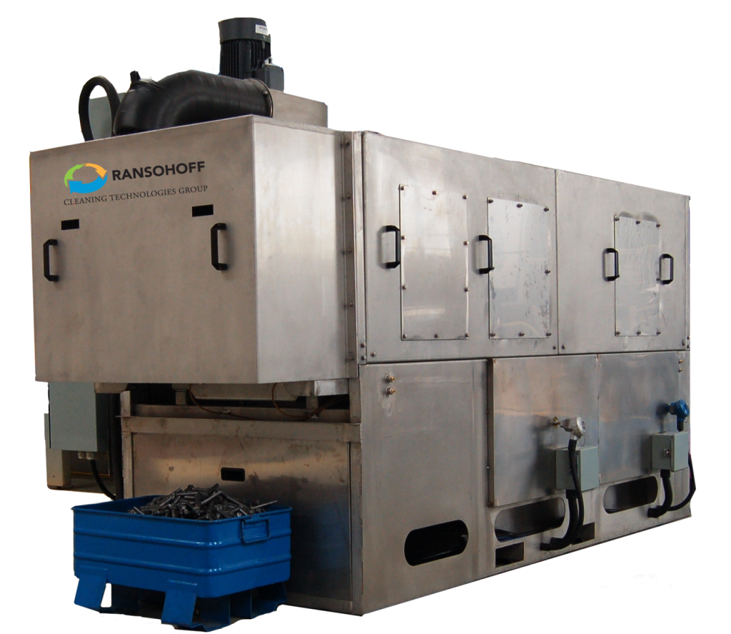

The LeanDrum Eco features a robust, low-cost option, utilizing stainless steel tanks, drum and housing, premium electrical components, full immersion cleaning system and forced air dryer technology to produce consistently high-quality cleaning results over an extended machine life. The new LeanDrum ECO is designed for easy maintenance access that will allow easy drum removal with no crane required.
The LeanDrum Eco is a wash, rinse and blow-off machine in a small footprint of 5.3ft. wide x 11ft. deep x 5.3ft. height. The part production rate is 12 cu. ft./hour at 2-rpm design drum speed with a variable-speed drive capable of 1-3 rpm. This machine offers full immersion cleaning, eliminating any need for pumps and nozzles.
