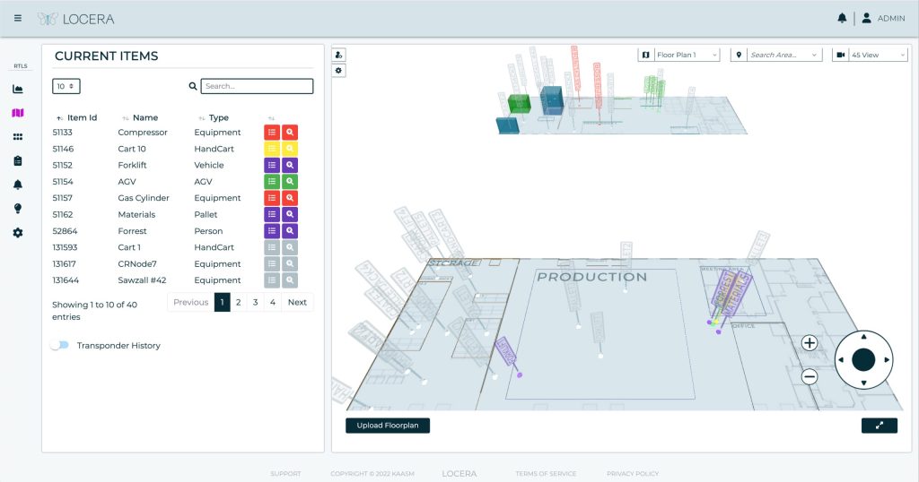

The cloud-native software analyzes and visualizes dynamic data, processes events, and can be addressed directly from local MES (Manufacturing Execution System) or ERP (Enterprise Resource Planning) systems via API or webhooks. The intelligence acquired based upon position data provides the user with a comprehensive overview of asset tracking, material flow, order information or possible problem areas.

The transponder ID is linked to the existing order data. For example, depending on the process step and order status, order information can be displayed on the SIMATIC RTLS ePaper transponders, providing a paperless solution. When the order ID is entered, the real-time positions of linked transponders are shown on the customer's digital card.
The insight achieved by this technology enables the individual optimization of production and logistics processes utilizing virtually defined areas known as geofences. 3D Geofences can be easily created in Locera via the desktop app or the augmented reality companion app and are used to detect entry into and out of exit from defined areas. The associated entry and exit events can be statistically evaluated, visualized, or linked to additional actions like alerts and notifications.
