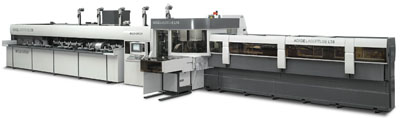

BLM GROUP USA has announced the introduction of the flexible Model LT8 laser tube cutting system.
February 1, 2015
The LT8 is a 3D CO2 laser tube cutting machine that provides excellent flexibility and user-friendliness for extremely precise laser cutting on tube diameters up to 8.625″ and a bar weight up to 1,000 lb.
The unit, equipped with a tilting, ±45° head, provides for three dimensional, five axis cutting and ultra high-speed piercing allowing for complex cutting on most tube profiles. The LT8 incorporates Active Focus, a technology that adjusts beam focal position. With Active Focus pierce times can also be reduced up to 30 percent and improves the tilt cutting speed.
The LT8 has up to 40 ft. loading capabilities, clean tube technology for processing of stainless steel, and other features that allow for a comprehensive laser tube cutting system.
The unit features an automatic loading system combined with a unique unload operation, increasing the productivity of most operations. Complex operations such as nesting multiple part numbers on the same bar and changing to different profiles, are managed automatically.
The LT8 is available in multiple load and unload configurations including an automatic bundle loader (capacity 8,800 lb), automatic step loader and/or a manual single bar loader. It is for large and/or thick tubes requiring a high degree of accuracy. Also standard with the LT8 is Artube, a complete, three dimensional CAD/CAM software package that provides for quick programming in simple to complex tube processing operations.
