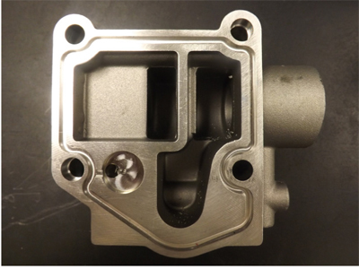

Lubricut 1117 from Chemtool Inc. is a high-performance and versatile, chlorine free, semi-synthetic based metalworking fluid designed specifically for daily and general applications for both aluminum and ferrous alloys. Formulated with the latest chemical innovations for lubricity, wetting, multi-metal corrosion prevention and biostatic protection available, Lubricut 1117 helps to establish the standard for outstanding performance without the need for chlorine, according to the company. The unique emulsifier and detergency package inhibits bacterial problems and hard water soap formation typically associated with traditional soluble oil metalworking fluids. Lubricut 1117 also utilizes a high viscosity base oil blend for increased boundary film lubrication and superior film strength on machined/ground surfaces. It contains 15 percent hydrocarbon oil.
Lubricut 1117 incorporates a synthetic surface lubricant technology which offers comparable performance to traditional soluble oils containing chlorine, sulfur or phosphorus without the performance issues associated with them. Lubricut 1117 is enhanced with specialized corrosion inhibitors which offer outstanding corrosion protection/anti-staining properties on aerospace and automotive aluminum alloys. Lubricut 1117 is the result of extensive microbiological challenge evaluations and the formulation is completely free of formaldehyde releasers and DCHA.
