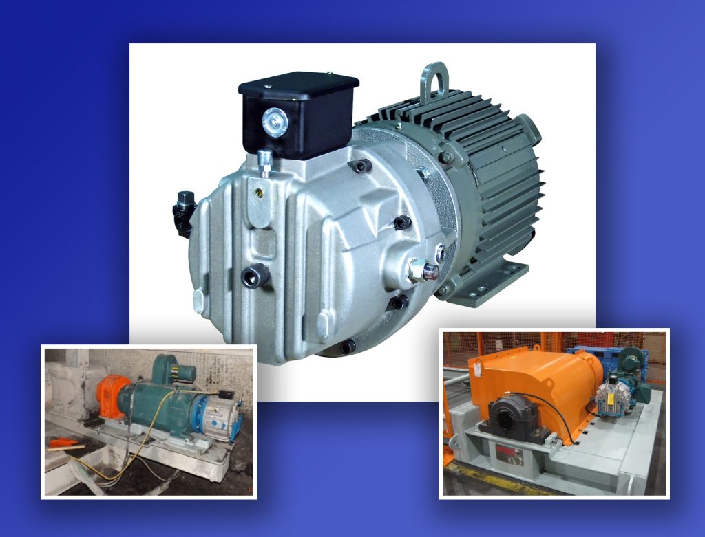

The MagnaShear motor brake from Force Control Industries employs oil shear technology, providing longer service life even in demanding applications like the frequent start/stop cycles seen on conveyors, or for critical holding applications like bulk conveyor loads. Proven oil shear technology transmits torque between lubricated surfaces, thereby eliminating wear on friction surfaces.
September 26, 2018
A patented fluid recirculation system dissipates heat, eliminating heat build-up–the most common problem in dry braking systems. Elimination of the wear significantly increases service life and virtually eliminates adjustment, which also elongates maintenance intervals, making this technology ideal for loader/unloader conveyors, rail car spotters and dumpers, ship and rail car loading conveyors, trippers and pallet return conveyors, as well as cranes, hoists and lifts.
A manufacturer with MagnaShear brakes stopping their overhead cranes and hoists reported significant reductions in preventative maintenance (more than 2 hours per week) and elimination of $8,000 annually in service-parts expenditures for repairs and maintenance.
The oil shear technology also provides a smooth “cushioned” stop, which reduces shock to the drive system, further extending service life of downstream components.
The totally enclosed MagnaShear brakes are impervious to moisture, dirt and dust that is common in concrete block plants, as well as asphalt shingle manufacturing, coal, bulk materials handling and forest products manufacturing.
Unlike dry brakes, oil shear technology includes a layer of automatic transmission fluid between the brake disc and the drive plate. As the fluid is compressed, the fluid molecules shear, thus imparting torque to the other side and causing the rotating surface to decelerate to a stop. Because most of the work is done by the fluid particles in shear, wear is virtually eliminated. Elimination of wear also eliminates the need for adjustments which are common for dry braking systems.
In addition to transmitting torque, a patented fluid recirculation system helps to dissipate heat, which is the major problem with traditional dry brakes.
Along with heat removal and torque transmission, the fluid serves to continually lubricate all components of the oil shear brake, elongating their service life.
MagnaShear brakes with oil shear technology provide significantly longer service life, characterized by virtually maintenance-free operations.
These proven motor brakes are available to accommodate a wide range of applications. Spring set torque ratings from 3 to 1,250 foot-pounds are available. MagnaShear motor brakes can be sized to the correct torque independent of the motor frame size or horsepower.
MagnaShear motor brakes have features for quick and easy mounting to drive motors in NEMA frame sizes 56 to 449. They are shipped ready to install, with no assembly or adjustments required. They are also available pre-mounted on a motor for severe-duty applications. MagnaShear motor brakes can be furnished to fit a NEMA or IEC frame motor, as a complete motor and brake assembly, or to mount on a machine frame or other special mounting configuration.
These proven motor brakes are totally enclosed from outside contaminants, with seal integrity for harsh and washdown environments. A modular design /assembly allows for ease of servicing and maintenance.
