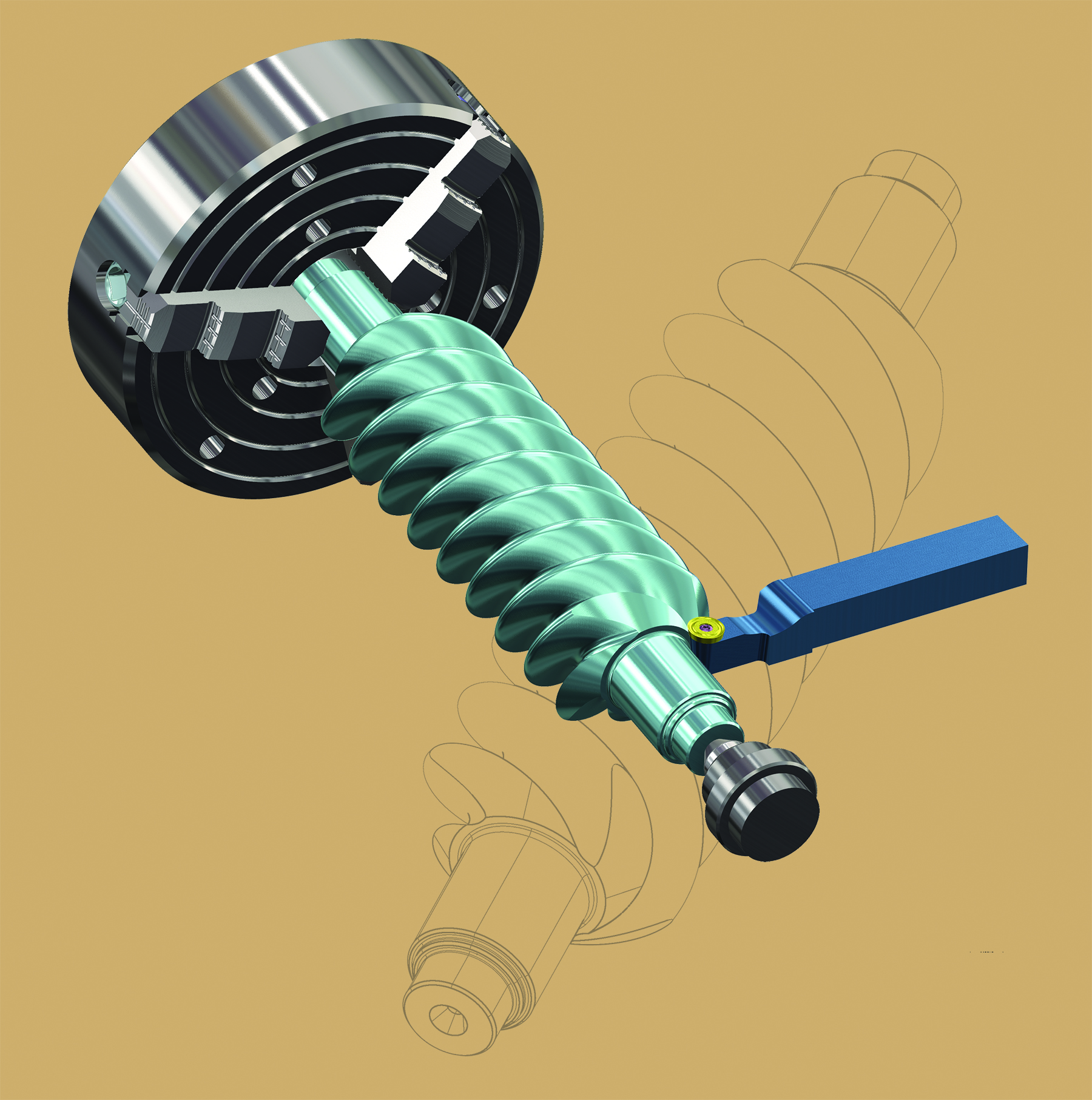

CNC Software, Inc., developer of Mastercam, the world’s leading CAD/CAM software, announces the release of Mastercam 2022 turning solutions. From accepting and programming any CAD file to Dynamic Motion™ roughing and precision finishing, Mastercam 2022 gives you a variety of options to turn all your parts exactly as you need them. Mastercam 2022 features new Mill-Turn support, enhancements to 3D Turning Tools, Stock Diameter, and much more.
