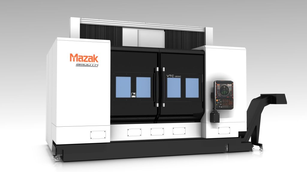

Mazak Corp. has further enhanced the VTC-300C Vertical Machining Center with the addition of the MAZATROL SmoothG CNC and its suite of SMOOTH TECHNOLOGY software solutions. The new control complements the VTC-300C's full traveling-column design, automatic tool changer and powerful 40-taper spindle, all of which combine to enable fast cycle times and accurate machining for extremely long and heavy workpieces in industries such as construction, agriculture and energy production.
November 27, 2018
Mazak Corp. has further enhanced the VTC-300C Vertical Machining Center with the addition of the MAZATROL SmoothG CNC and its suite of SMOOTH TECHNOLOGY software solutions. The new control complements the VTC-300C’s full traveling-column design, automatic tool changer and powerful 40-taper spindle, all of which combine to enable fast cycle times and accurate machining for extremely long and heavy workpieces in industries such as construction, agriculture and energy production.
Job shops and major manufacturers alike will benefit from the VTC-300C’s new MAZATROL SmoothG CNC and its innovative programming, performance and monitoring functions, as well as the ability to use both EIA/ISO and conversational programming to bring optimum speed and accuracy to complex part production. Advanced hardware – including a pivoting CNC panel and intuitive, 19″ multi-touch LCD control screen – allows for complete ease of use, while a CFast memory card stores up to 32GB of program data.
The new control complements the existing VTC-300C machine platform, which delivers a standard 15,000-rpm, 30-hp (10 percent ED, 110 nM) 40-taper spindle capable of handling a wide variety of metalcutting applications. Additionally, the machine and waycover design has been enhanced to provide 1,582-ipm rapid feed rates on all axes. Its fixed 78.74″ by 30″ table provides process flexibility for a range of applications, while an optional center partition can divide the work envelope into two separate work areas to allow the machine to be in cycle in one area while loading, unloading or setting up a part in the other. The machine’s axis travels are 65.35″ in X, 30″ in Y and 25.6″ in Z.
For additional process flexibility, manufacturers can double the standard 24-tool automatic toolchanger’s capacity with an optional 48-tool magazine or upgrade the spindle to a 50-hp, 20,000-rpm integral spindle. Plus, standard integration of Intelligent Thermal Shield (ITS) software helps maintain machine accuracy in a wide range of factory environments. The VTC-300C machine can also be seamlessly integrated into a variety of robotically loaded solutions provided by Mazak Automation Systems, and its new SmoothG control makes it easy to take advantage of machine monitoring software like SMOOTH Link and IIoT connectivity tools like MTConnect and the Mazak SmartBox.
