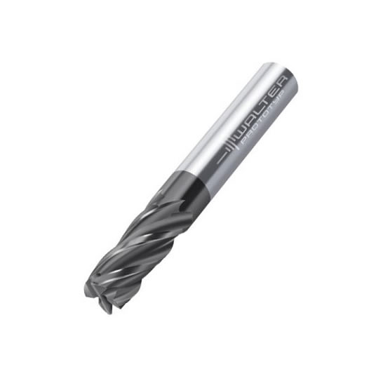

Walter USA, Waukesha, Wis., recently introduced its new Advance product line, which the company claims increases tool life up to 50 percent.
The MC251 Advance solid carbide milling cutters from Walter's Prototyp brand is said to be the ideal geometry for machining stainless materials from material group ISO M and for secondary applications in ISO S materials, according to the company. The new MC251 tool family is designed to operate most efficiently on machines having only an external coolant supply.
The MC251 product family comprises a tough carbide substrate (WK40RC), which has been specifically designed to provide a high level of machining reliability. The tool's coating, made from a combination of titanium aluminium nitrate (TiAlN) and aluminium titanium (AlTi), is designed to increase tool's service life as well as provide anti adhesion properties.
