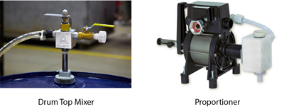

Mechanical Concentrate Mixers from Eriez HydroFlow eliminate the need for traditional manual fluid mixing methods which often result in imprecise concentration control. Eriez offers Drum Top Mixers and Proportioners to fulfill customers’ specific requirements.
Keeping tight control of the fluid concentration ensures that fluid will not get too lean or too rich. When the concentration is too lean, the result is often rust, bacterial infestation and poor tool life. When the fluid concentration is too rich, the rich mixture will waste expensive coolant concentrate, may cause skin irritation and can adversely affect the metalworking fluid’s cooling ability at the point of cut.
The Eriez Drum Top Mixer is a compact, easy-to-use venturi mixer for combining water with coolant concentrates. Water jetting through the unit creates a vacuum that siphons concentrate from the drum. A needle valve allows for infinite adjustments across the mixture range. Models are available in three, 10 and 25 GPM versions, with mixing range adjustable from two to 10 percent.
