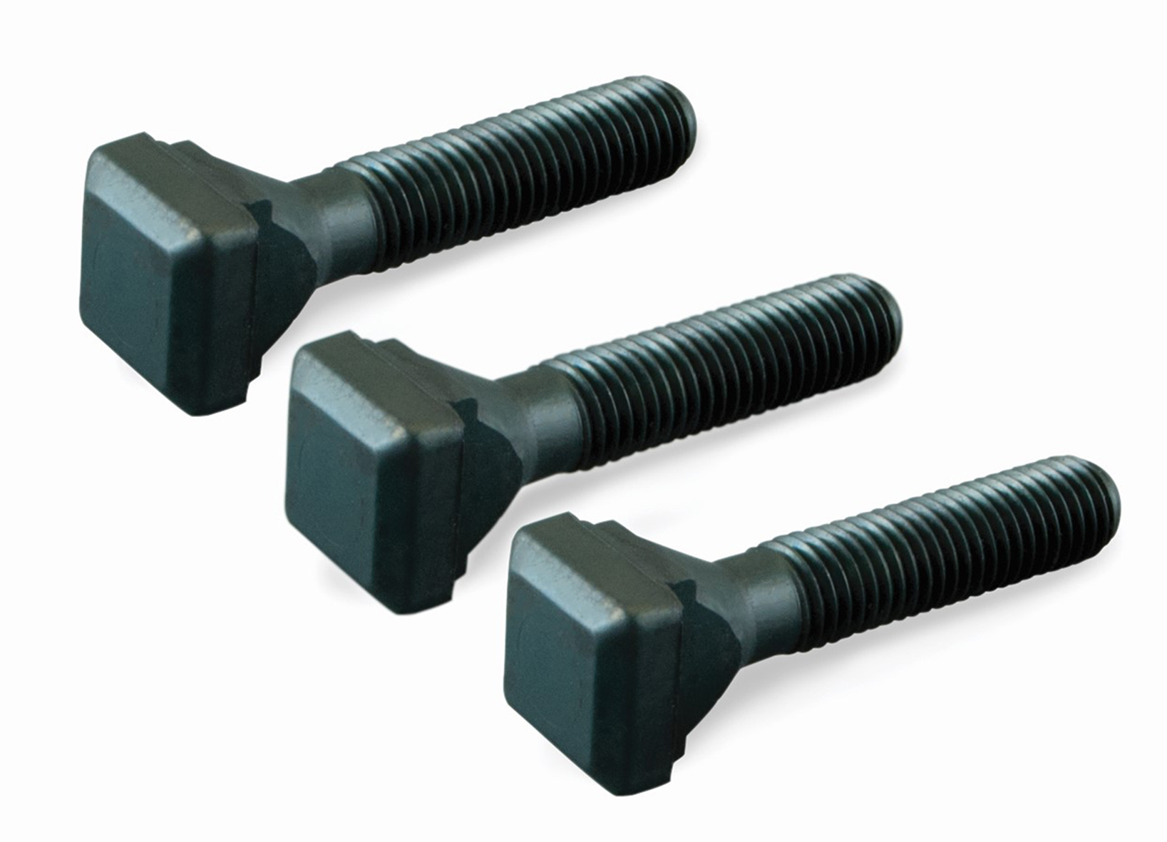

WDS Component Parts Ltd. has extended its offering of medium-tensile T-bolts with the addition of a forged steel option that provides more strength and wear resistance than mild steel. These are aimed at applications where the high strength of low-alloy, high-tensile steel bolts is not appropriate.
October 10, 2017
Designed for use with a threaded clamp, to position and secure workpieces for industrial machining, the T-bolts are manufactured in tempered forged steel. Available in sizes from M8 up to M30, and in lengths from 32mm to 400mm, they provide reliable fixture holding in high-vibration and large-diameter applications.
T-bolts have a square or rectangular shape for use in T-slots to provide flexible clamping systems for workpieces. T-bolts are similar to T-nuts in operation, but offer a male threaded extrusion for attaching modular elements to the fixture application.
The T-bolts are available in two tensile gradings. They meet Class 10.9 standards up to M12 for a minimum tensile strength of 1040Mpa, along with improved yield strength and proof strength, meeting the needs of heavier duty applications. Above size M16 they meet Class 8.8 standards offering a minimum tensile strength of 830Mpa.
Visitors to the WDS website are able to download 2D and 3D CAD models of the T-bolts, and can place orders for delivery using a number of different currencies.
The T-bolts form part of the huge range of T-nuts and T-bolts available from WDS. Both metric and imperial sizes are available, as well as standard products and special designs such as rhomboidal, blank and stainless steel products.
