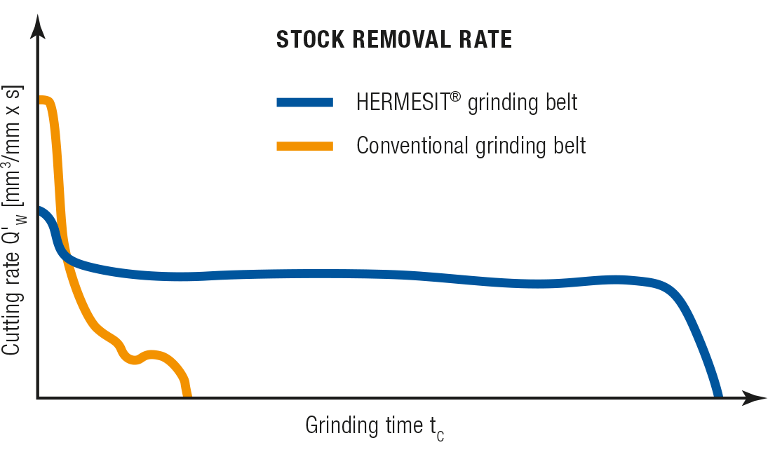

Graph showing stock removal rate. Photo credit: Hermes Abrasives Ltd.
Comparison of grinding values Hermes-belt HERMESIT RB 535 Y, grain P 120, against a conventional grinding belt RB 377 YX, grain P 120. (Grinding machine: Loeser cylindrical grinding machine Material: stainless steel pipes (stainless steel 1.4301).
Certain machine or workpiece conditions only require low grinding pressure and therefore the agglomerate technology is not best suited. HERMESIT technology with the high-performance belt HERMESIT RB 535 Y is an alternative solution for low-pressure applications.

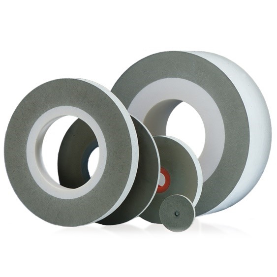

As a final step before chrome plating piston rods, final polishing may be required. This can be achieved with grinding wheels in polyurethane bond with an extremely fine grain size. The aim is to produce surfaces with very high quality, i.e. a final roughness values of Ra < 0.1 µm. At the same time, they should be spiral-free and high-gloss.
Hermes offers microlite polishing wheels in which a polyurethane-based binder interspersed with abrasive grain is formed into wheels of varying hardness and elasticity in a special process. Compared to conventionally bonded grinding wheels, the significantly softer and more flexible matrix of grain and bond allows the creation of surface characteristics that are unique in terms of low roughness and high degrees of gloss.
These microlite polishing discs meet the highest demands in terms of surface gloss and low surface roughness. Photo credit: Hermes Abrasives Ltd.
