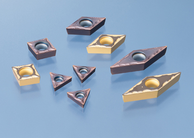

Sumitomo Electric Carbide Inc. adds MESI Chipbreaker for Swiss-style turning and small parts machining.
Featuring a 15 degree nose and a sharp 8 degree main edge, the MESI provides a low cutting force. Studies have shown the MESI to perform with high wear-resistance in applications using titanium, according to the company. A wavy cutting edge maintains better chip control (for bar feeder machines), while the incorporation of dimples reduces cutting temperatures.
The MESI is suitable for medical parts and high-precision parts machining. Available geometries include CCGT, DCGT and VCGT; grades include AC510U/ 520U/530U/AC610M/630M.
