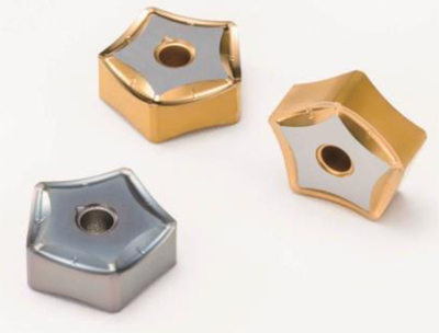

Kyocera’s new MFK cast iron milling cutter utilizes a newly developed double-sided insert with 10 cutting edges. Although negative inserts offer cost benefits because cutting edges can be formed on both sides of the insert, they tend to increase cutting resistance, causing a decrease in sharpness or an increase in chattering. To address this challenge, Kyocera has developed uniquely shaped inserts using its proprietary molding technology, which reduces both cutting resistance and chattering.
The inserts also improve machining quality through a double-edge structure in which two cutting edges are provided for the insert corners. Kyocera’s MFK milling cutters offer improved quality and better cost performance in machining cast iron, with higher productivity in conditions ranging from roughing to finishing.

1-A. Proprietary edge shape reduces cutting resistance The newly developed negative inserts utilize two lead angles per corner. Using molding technology developed by Kyocera, a large axial rake angle is provided on cutting edges, reducing cutting resistance and facilitating smoother machining. Increasing the lead angle also reduces cutting resistance in an axial direction of the workpiece, vibration and chattering.
1-B. Double-edged structure helps prevent inserts from fracturing and breakout A proprietary double-edged structure using two main cutting edges is utilized on each corner to cushion initial shock at the moment of workpiece contact, the onset of cutting. This helps prevent inserts from fracturing and breakout, helping to stabilize the machining process and improve finish quality.
2. Newly developed CVD material for cast-iron milling offers long tool life and stable machining Kyocera has added the new CA420M CVD1 material for cast iron milling to its insert grade lineup. CA420M is comprised of a newly developed, high-toughness base substrate with a new CVD coating developed using proprietary crystal-control and film-formation technologies. Improved abrasion resistance, essential in machining cast iron, will allow CA420M to deliver better cost performance, longer tool life and a more stable machining process.
