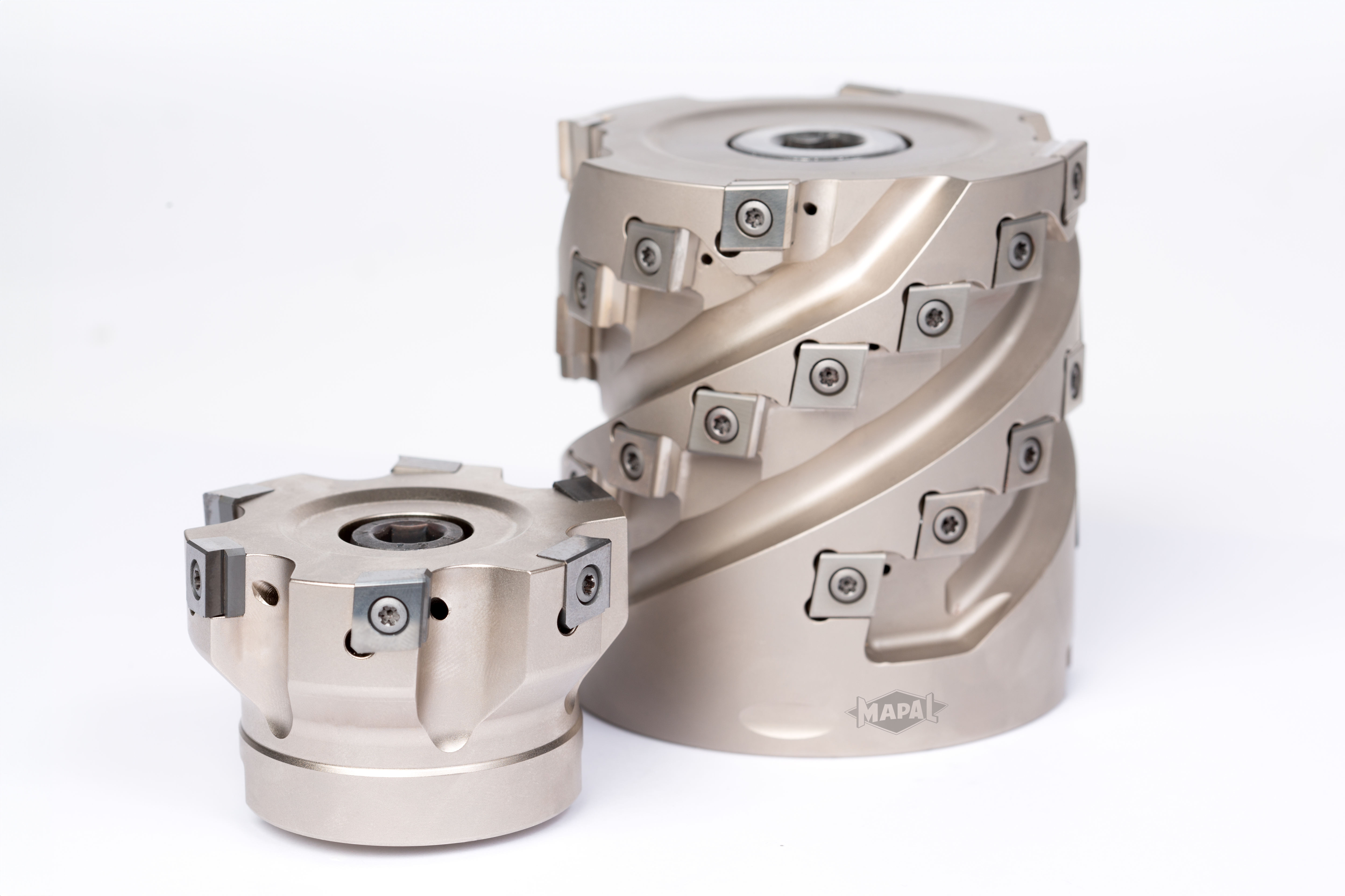

NeoMill Alu-Rough
ith the NeoMill-Alu-Rough corner milling cutter and end mill, MAPAL offers an innovative solution for roughing aluminum castings in the automotive, aerospace, and mechanical engineering industries. Single-row milling cutters with diameters from 50 to 160 mm are available as standard, while the NeoMill-Alu-Rough end mill is also available in multi-row versions with diameters of 63, 80, and 100 mm. Custom tooling solutions can also be configured. The combination of large chip spaces, tangential indexable inserts, and a wide selection of cutting materials (PCD, coated or uncoated carbide, CVD diamond) ensures reliable chip evacuation and high stability – even with large chip volumes.
