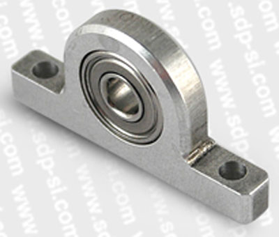

Stock Drive Products offers miniature pillow block ball bearings from Spyraflo. As an exclusive authorized distributor, SDP carries many different types of Spyraflo bearings for small quantity orders. These miniature, compact design pillow block ball bearings are ideal in applications with limited space, according to the company.
October 13, 2013
Stock Drive Products offers miniature pillow block ball bearings from Spyraflo. As an exclusive authorized distributor, SDP carries many different types of Spyraflo bearings for small quantity orders. These miniature, compact design pillow block ball bearings are ideal in applications with limited space, according to the company. With an aluminum housing, stainless steel bearing and double shielding, they have excellent corrosion resistance, making them suitable for medical, scientific and pharmaceutical applications.
Identified as the A 7Z29… and A 7Z29M… series, these ABEC 3 bearings are available in both inch and metric sizes, for shafts ranging from 1⁄8” to 3/8″ and 4mm to 10mm. They are rated for speeds up to 56,000 rpm and radial loads up to 450 lbf, and have an operating temperature of -22 to 248°F. They are also lubricated for the life of the bearing and are maintenance-free.
