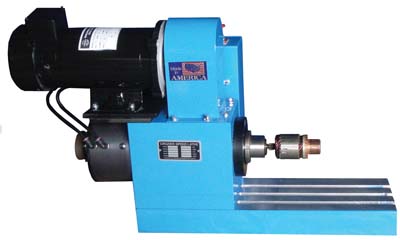

Crozier Machine Tool Co. announces the introduction of the "BUILDING BLOCK" platform Model 30DC-BB, which when mated with our Model 30DC Speed Lathe becomes a mini-machining cell ideal for many second operations.
Crozier Machine Tool Co. announces the introduction of the "BUILDING BLOCK" platform Model 30DC-BB, which when mated with our Model 30DC Speed Lathe becomes a mini-machining cell ideal for many second operations. Mount whatever you need to its rigid T-slotted base and you are ready for the next operation.
The Model 30DC-BB is Ideal for deburring, gauging, finish sanding, inspection, lapping, turning, assembly or light dry machining of any part that can be held by a collet. The Model 30DC-BB is portable and small enough for placement next to your CNC to perform a variety of operations. Rapid setup, quick cycling, and variable speed the DC30-BB will free up your expensive production equipment. Available for immediate shipping.
Features include:
0-3200 RPM variable speed
120V Single Phase
5C Air Collet Closure Foot Operated
Cast Aluminum Housing
0ne HP Motor Multi-Belt Drive
T-Slotted Aluminum Rigid Base
Dynamic Brake
Sealed Bearings
1.125" Spindle through-hole
4.125" Spindle height
