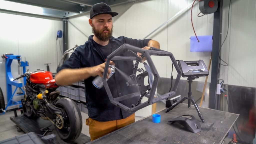

Reference frame holds small parts
The modular frame from AESUB consists of approx. 30 individual components from which a measuring device with a diameter of 200 or 300 millimetres is assembled within just a few minutes. Its constituent elements are black and hence ideal for scanning tasks. They are produced from aerospace material and are only half the weight of comparable aluminium components. Thanks to additive manufacturing, the plug-in and screw connections are directly integrated, which means that the components can be screwed or fitted together without the need for tools. The set is housed neatly in a carrying case. It saves space and is particularly suitable for mobile use.
The height of the frame is based on the size of the part. The components present in the set permit a maximum set-up height of 300 millimetres. With add-on sets, the frame height can be extended in increments of 100 or 200. The part to be measured is held within the frame by hinged brackets.
Reference points on the frame – 360° measurement in one go
For orientation purposes, most scanners require ‘reference points’ which are generally glued directly onto the parts. But depending on the nature of the surface, removing them may be problematic and may damage the part. With larger parts, there is the risk that individual points are missed.
With the reference frame, it is no longer necessary to glue the parts because the points are applied directly on the frame. Hence they can also be used as a reference for all further parts.
By means of the reference frame and the points, the dimensions of the part can be captured in one all-round scan – rapidly and precisely.

After spraying, a homogenous white layer is generated within a few seconds, which produces high contrast values on the surface. The scanner can now detect the structure without a problem. The layer thicknesses of the AESUB spray are between 1µ and 15µm. The matting layer is touch-dry, which means that the parts can also be handled and repositioned during the scanning process. The sublimation times of the AESUB sprays vary between four and twelve hours depending on the spray variant.
AESUB spray and dots
TheAESUB spray and dotsare a handy addition to the reference frame. The reference points can be placed on the object to be measured both before and after spraying with the AESUB scanning spray. The reference points stick to the spray layer and can be easily removed.
