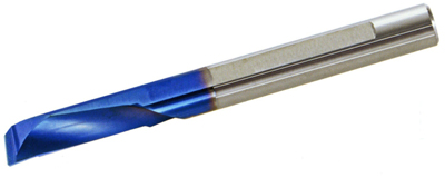

The latest addition to the Carmex Tiny Tool line—the multi-task CMR—allows users to bore, turn, face and chamfer with a single tool.
August 1, 2015
The latest addition to the Carmex Tiny Tool line—the multi-task CMR—allows users to bore, turn, face and chamfer with a single tool. The unique cutting geometry reportedly permits machining without the need for a pilot hole, thereby saving the time and expense of an entire operation. Designed with a vertical coolant hole and a spiral flute, the CMR continually evacuates chips out of the hole during machining.
“The new CMR Tiny Tool not only shortens machine cycle time but, thanks to the variety of operations it performs, it saves money on tooling,” according to Jeff Dei, president of Carmex USA. “Submicron carbide, coupled with BMK grade carbide and advanced PVD triple layer coating, improves finish and yields longer life. CMR delivers unprecedented versatility, combined with productivity and dollar savings.”
