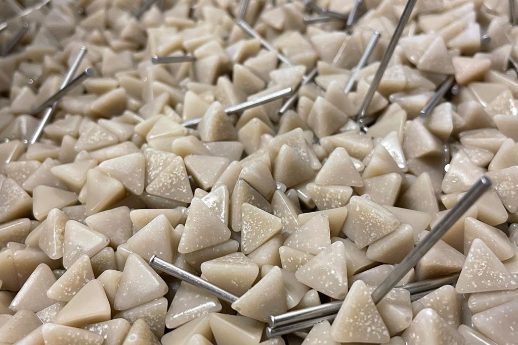

This media has a patented shape without any flat, parallel surface areas. On the one hand this unique design prevents media lodging in the work pieces, which can occur particularly in case of complex work pieces. Such lodged media can severely affect the finishing process and must frequently be removed by hand.

Such an innovation is the new MultiShape ceramic media. Compared to all other products currently available in the market, this media has a patented shape without any flat, parallel surface areas. On the one hand this unique design prevents media lodging in the work pieces, which can occur particularly in case of complex work pieces. Such lodged media can severely affect the finishing process and must frequently be removed by hand. On the other hand, the shape with its rounded surface areas allows the surface refinement of work pieces, which to-date could not be handled by mass finishing at all or only with very complicated operational setups. This includes components with difficult-to-reach surface areas like tight radii, undercuts, notches and slits, which can frequently be found in stamped and bent components. The unusual ceramic media also allows the effective and homogeneous finishing of external and internal surface areas on tube segments and cup-shaped components like housings and deep drawn parts.
Compared to traditional ceramic media, the new product is also characterized by a faster and more dynamic motion of the work piece/media mix and a higher material removal rate. This results in up to 10% shorter finishing times. Therefore, the new media represents a significant contribution towards higher productivity and cost-efficiency. Another important attribute of the MultiShape media are its uniform wear characteristics. This excellent shape retention feature allows a longer media use, which is positively affecting the operating costs. The grinding intensity can be adjusted to the respective finishing application through different ceramic compositions.
