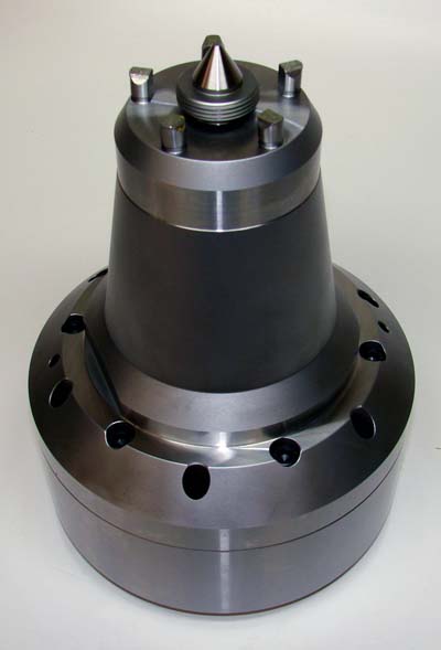

LMC Workholding introduces new Neidlein FFBHZ face drivers for gear grinding, gear hobbing and gear milling, suited for high runout result operations with zero backlash.
August 1, 2010
LMC Workholding introduces new Neidlein FFBHZ face drivers for gear grinding, gear hobbing and gear milling, suited for high runout result operations with zero backlash. The Neidlein FFBHZ face drivers design offers less down time when changing drive diameter ranges within one face driver size. Hydraulic compensating drive pins guarantee shear force-free clamping of workpieces with badly machined surfaces at clamping areas. The built-in hydraulic cartridge is easy to change and maintain. Neidlein face drivers quickly grip and turn a workpiece from its end, allowing the entire part to be machined in just one operation, including cutting off the ends and eliminating the need to flip the part. Face drivers allow turning applications to have increased flexibility to lower cycle times and allow large interrupted and heavy cuts.
