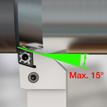

Neoturn is a Multifunction Line of Inserts and Toolholders for External Turning, Face Turning and Profiling Operations
NEOTURN inserts feature a unique head angle of 70° which provides extra clearance compared to conventional CNMG 80° inserts with additional strong points compared to DNMG 55° inserts.
The NEOTURN XNMG inserts have the advantages of both the CNMG and DNMG inserts, and combine the advantages of both which provides the winning edge.
NEOTURN offers the most popular turning chipformers for steels such as F3P and M3P, and F3M and M3M for machining stainless steel in medium and finishing applications.
The NEOTURN XNMG demonstrates excellent chip control and highly stable tool life in a wide range of applications. The NEOTURN system also enables machining complicated workpiece shapes close to the tail stock where space is limited. This can be performed without replacing the holder and decreases setup time substantially.
NEOTURN provides the advantage of using one tool for longitudinal, face and profile turning. The integrated shape of both CNMG and DNMG insert geometries enables the reduction of tool and insert inventory.
