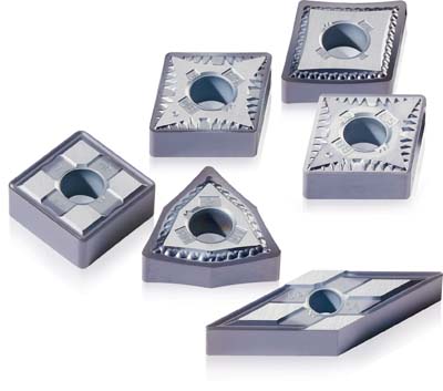

New Beyond grades from Kennametal are delivering higher productivity for turning tough alloys, both in higher speeds and feeds (faster turnaround time) and longer tool life (more parts per tool). KCU10 is specifically engineered for increased performance in OD and ID turning, grooving, plunging, undercutting, and threading. KCU25 covers threading, grooving, cutoff, and selected additional turning applications. Both take advantage of new PVD (physical vapor deposition) coating technology, including special surface treatments that improve machining performance in high-temperature materials.
In many cases, speeds, feeds, or depth-of-cut can be increased, while related wear issues like depth-of-cut notching are reduced. KCU10 additionally features a dual-layer coating application, a top layer of AlSiTiN atop a second layer of AlTiN. The boundary between the two serves to help deflect micro-cracks.
