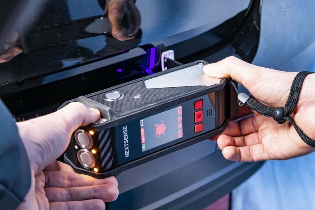

The new, wireless CALIPRI C15 complements the wired CALIPRI C11, which provides continuous laser-based, hand-guided gap and flush measurements on a production line, including in the automotive, aerospace and domestic appliance industries. Because the CALIPRI C15 is cable-free, operators can use it to quickly reach hard-to-access areas and it can be configured for 360° or linear measurement, making it ideal for car body, inline and final assembly inspections as well as in rework stations. All data synchronization is performed wirelessly and in real time.
Clemens Gasser, CEO of NEXTSENSE, said: “CALIPRI tools are critical in sectors where a perfect finish strongly influences buying decisions and impacts customer experience. Top automotive OEMs and tier one suppliers, for example, use our range of CALIPRI measurement tools to attain the highest perceived quality for a car body’s fit and finish and to eliminate irregular gaps that are a source of noise pollution.”
In addition to bringing extra flexibility to handheld inline measurement, the CALIPRI C15 uses blue light laser technology. This makes it suitable for measuring shiny surfaces, including the hemming on car doors and brushed metal surfaces. It is also equipped with a small screen where operators can check measurement data on the fly, and its sturdy design means it can withstand knocks, collisions and prolonged, repetitive use.
The C15 is available in two versions: the C15 Fix, which is optimized for stationary measurements, and the C15 Flex, which is designed for versatility and can be moved easily from one production line to another.
