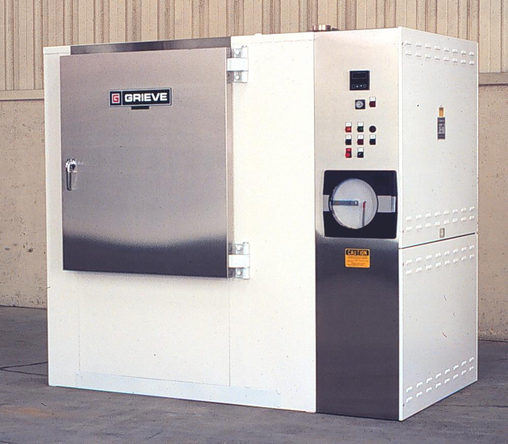

No. 836 is a 750° F electrically heated Class 100 clean room oven from Grieve, currently used to bake various coatings onto products at a customer's facility.
March 1, 2018
No. 836 is a 750° F electrically heated Class 100 clean room oven from Grieve, currently used to bake various coatings onto products at a customer’s facility.
Workspace dimensions of this oven measure 36″ wide x 36″ deep x 39″ high, and 30kW installed in Incoloy sheathed tubular heating elements provide the maximum temperature of 750° F, while a 1,000 CFM, 1½-hp recirculating blower maintains horizontal airflow across the load.
No. 836 features a Type 304, 2B finish stainless steel interior with continuously backwelded seams, an exterior finished with white epoxy paint #4, brushed finish stainless steel door face and control panel face. The oven has 6″ insulated walls and an aluminized exterior.
Additional equipment on this Grieve oven include a 30″ x 24″ x 6″ thick stainless steel high temperature HEPA recirculating air filter, digital programming temperature controller, manual reset excess temperature controller with separate contactors, recirculating blower airflow safety switch and a 10″ diameter circular chart recorder.
