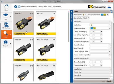

Select and Advise: This is the stage where users evaluate machining strategies based upon machine, material, part features, and specs. What is the best approach? How long will it take? How much will it cost? Which tools do I need?

DP Technology imports NOVO (now part of NOVOsphere) tooling data into its latest version of ESPRIT cloud-enabled CAM software. This not only saves part programmers hours of time as opposed to manual tool creation, the part programs are better because the data is based on real tools that can be selected based on part features, work material, surface finish requirements, or whatever aspects of the job are most critical.
The value of NOVO data is not limited to the programming or process planning department. On the shop floor, presetting tools and tool assemblies is a valuable time-saver. ZOLLER, a leader in automated presetting and balancing machines, knows customers can import NOVO data from the Machining Cloud and know they have precise and reliable tool dimensions, offsets, and other critical data to make presetting reliable and valuable.
Since the 2013 launch of the NOVO original Tool Selector, Tool Configurator, Tool Advisor, and Job functions, NOVO has added connectivity to E-commerce, easy ISO 13399 exports, and seamless integration to the ToolBOSS tool management system via the Machining Cloud. Specifically, NOVO users can request a price quote from their local Kennametal Distribution Partners by transferring their shopping cart list to them via the "Request Quote" button. The distributor will receive a notification with complete detail of the items and requestor information to respond.
A new pop-up also makes it easy to add spares and other individual items to existing shopping carts. Spare parts are clearly identified as "included" or "non-included" on bills of material. ToolBOSS users on the cloud with the latest software version can now use NOVO to see if an item proposed for a process plan is already available in their ToolBOSS inventory, making both plans and budgets more efficient. Customer part numbers are automatically populated in NOVO Tool Advisor results and Tool Availability pop-ups via the ToolBOSS database.
