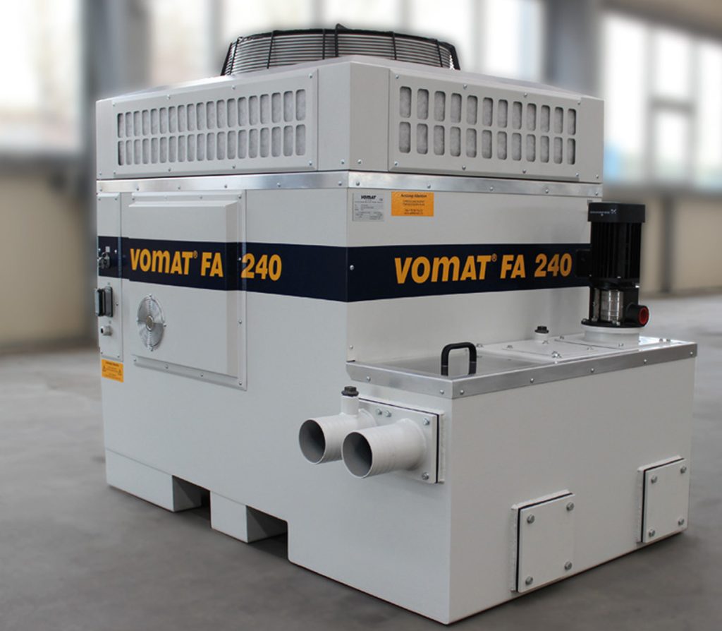

An important parameter in filtration is the particle size and thus the degree of purity of the cooling lubricant after the filtration process. VOMAT fine filtration systems filter to NAS 7 (3 – 5 μm) quality and particle size. VOMAT filters operate in full-flow mode and separate dirty and clean oil. This is the prerequisite to permanently provide the manufacturing process with the cleanest grinding oil. At the same time, the system filters and cleans the machine as required. This means that the backflush cycle is initiated automatically for each individual filter element, depending on need. The other filter elements ensure a continuous clean-oil supply to the work piece while the soiled filter element is cleaned. Low heat transfer into the cooling medium, reduced energy consumption as well as economical, problem-free waste disposal is further strengths of the VOMAT technology.

VOMAT micro filtration systems are available in various sizes from 70 to 960 liters/minute (18 to 254 gpm) filter capacity. Thanks to a variety of add-on modules, VOMAT systems can be tailored to every conceivable plant configuration. From smaller stand alone units to plant wide high capacity central systems can be realized without major problems.
