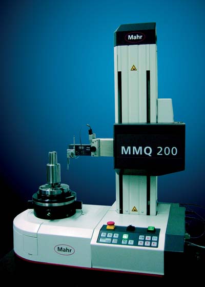

Mahr Federal Inc. has introduced a new option package for their MarForm mmQ 200 Formtester which provides the measurement of surface finish parameters according to accepted ISO, ASME and JIS standards.
July 1, 2010
Mahr Federal Inc. has introduced a new option package for their MarFormmmQ 200 Formtester which provides the measurement of surface finish parameters according to accepted ISO, ASME and JIS standards. With the combined hardware/softwaremmQ 200 Surface Finish option, operators will benefit from reduced set-up and measurement cycle time, and reduced cost by needing only a single piece of equipment for both form and surface measurements. “The key to providing accurate surface finish data with a form machine is high resolution and low residual noise,” said Pat Nugent, Vice President Metrology Systems for Mahr Federal. “Unlike many form measurement machines that are designed to measure longer wavelengths and allow 5-10µm between data points, the controller for themmQ 200 was designed with roughness measurements in mind. It can sample data with spacing down to 0.5µm, well within accepted international standards for roughness measurement.” The roughness option package for themmQ 200 utilizes the same skidded diamond tipped PHT stylus as is used on Mahr Federal’s PS1 and M300 surface finish machines, and the same MarWin-based surface finish software as the MarSurf XR 20. The stylus is mounted opposite the ruby-tipped form probe on themmQ 200’s motorized T7W probe head. ThemmQ 200 automatically swivels the probe to apply the diamond stylus, and changes from horizontal to vertical measurement as needed, utilizing standard surface finish parameter cut-off lengths. A skidless probe measuring option is also available. Optimized for measuring cylindricity and other deviations of form and position, themmQ 200 Formtester comes standard with Mahr’s newest EasyForm Version 3 software. ThemmQ 200 is compact, fast, easy to learn and operate, and is equally at home in the metrology lab or on the shop floor. The new hardware/software package for surface roughness measurement is available as an option and also includes Mahr’s Advanced Form software for creating automated solutions for even the most demanding applications. This ease of operation makes themmQ 200 ideal for use by machine operators right in production areas where immediate measurements can minimize scrap, save time and reduce production costs. Optimized for the measure of cylindricity through rotational table axis and vertical axis integration, themmQ 200 can also perform a full range of ISO and/or ASME form checks, including: roundness, straightness, flatness (from a polar trace), parallelism, concentricity, coaxiality, run-out, total run-out, taper, perpendicularity, angularity, and angle sector (roundness, flatness, run-out).
