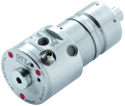

Designed like the Ott-Jakob type GD rotary union with permanently sealed surfaces, this newly developed rotary union from Advanced Machine & Engineering Co. also offers an integrated sensor that monitors leakage.
The new rotary union with leakage sensor, along with our analog position monitoring sensor, offers constant control of a clamping system, preventing costly damages to the clamping system or spindle. Maximum RPM: 36,000; maximum coolant pressure: 80 bar; cleaning air maximum: 10 bar; maximum air pressure (after confirmation): 5 bar; filter porosity: <50.
