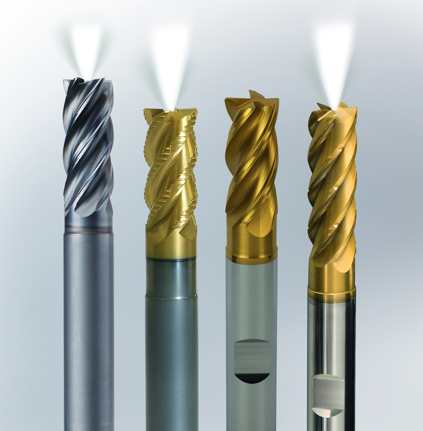

TiNox-Cut End Mills
Products June 23, 2021
TiNox-Cut End Mills
TiNox-Cut End Mills are made from premium ultra-fine micro grain solid carbide with a maximized transverse rupture strength for high impact applications, and produce impressive results compared to conventional end mills. Advanced PVD-applied multi-layered coatings withstand excessive heat and provide superb wear resistance for longer tool life, and tool geometry is designed to produce minimal vibration when machining tough materials.

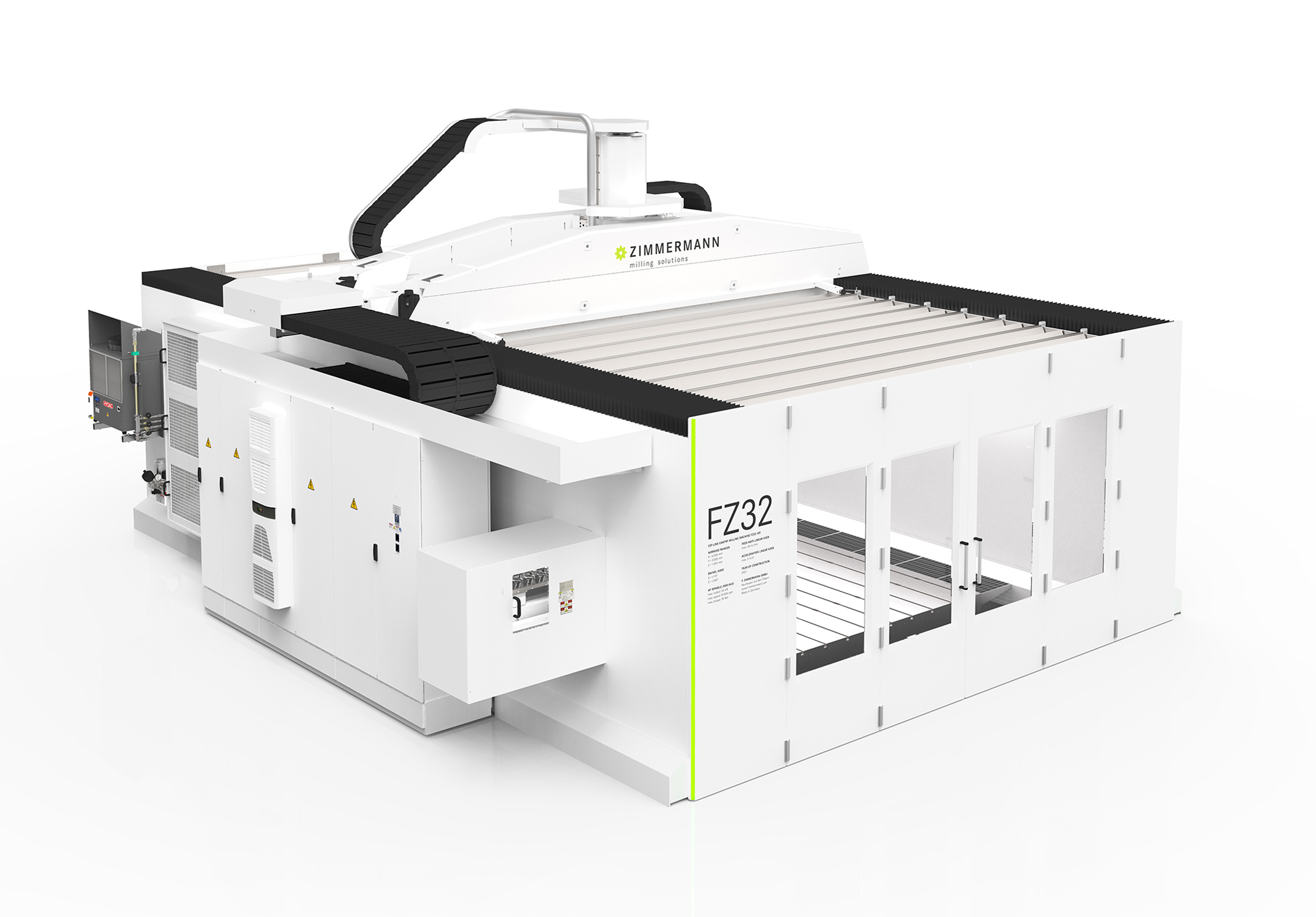

FZP Machine Line
FZP Machine Line
The "lightest" machine in the FZP line is the new FZP32 with a working range of up to X = 10, Y = 4 and Z = 2.5 meters (393" x 157" x 98"). The user can machine block materials, plastics, as well as CFRP, GFRP and aluminum, among other materials. Due to the large working area, it is also possible to mill components completely without reclamping. "The modular design of the machine offers the possibility to consider different options.
