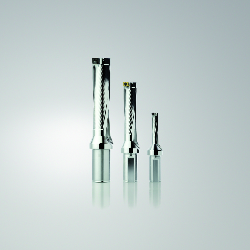

With a new reengineered design, the Seco Perfomax indexable insert drill delivers higher drilling parameters and longer tool life as well as exceptional chip control and evacuation. The drill's innovative features include new flute designs with special anti-friction surfaces and laser hardened fronts for added strength, stability and accuracy.
October 18, 2017
With a new reengineered design, the Seco Perfomax indexable insert drill delivers higher drilling parameters and longer tool life as well as exceptional chip control and evacuation. The drill’s innovative features include new flute designs with special anti-friction surfaces and laser hardened fronts for added strength, stability and accuracy. For a deeper look at Insert Geometry Resources, see this supporting resource.
Perfomax flutes feature improved helix angles along with smoother chip flute exits and Seco’s engineered wave pattern that minimizes contact between chips and flute surfaces. The drill generates shorter chips that evacuate quickly and easily to significantly reduce the risk of chip jamming for higher application security.
For up to 140 percent longer drill body tool life, Seco laser hardens the fronts of Perfomax’s flutes. A hardness of HRC 60 allows the drill to withstand chip erosion for much longer periods of time. The re-engineered design of the Perfomax drill also features a bigger radius at the bottom of the drill’s insert pockets for added rigidity.
In tandem with Perfomax, Seco’s DS2050 and DS4050 insert grades are especially well-suited for heat-resistant materials like titanium and titanium alloys. The grades enhance productivity and extend tool life thanks to recently developed free-cutting MP and MC geometries. DS2050 are inserts for periphery cutting, and DS4050 are those for center cutting.
Perfomax drill bodies are available in diameters ranging 0.594″ to 2.375″ (15 mm to 59 mm); in length-to-diameter ratios of 2xD, 3xD, 4xD and 5xD; and in most spindle interfaces.
