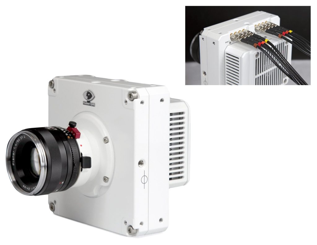

The camera combines high-speed image quality with direct data transfer speeds up to 9 Gpx/second to capture 938 frames per second (fps) at full 9-Mpx 4,096 x 2,304 resolution. It brings the power of high-speed streaming data to machine vision applications, significantly increasing capabilities across both traditional high-speed and streaming applications.
The Phantom S990 leverages the same CMOS 9.4-megapixel sensor found in the Phantom Flex 4K high-speed camera, capturing 12-bit images and delivering exceptionally high image quality. Using up to 16 standard CoaXPress (CXP6) channels, the S990 is compliant with GenICam and streams directly into PCI Express frame grabbers.
The camera also features a general-purpose input/output (GPIO) for fast, flexible signaling and synchronization. It includes signals beneficial in standard high-speed applications, such as time code in and out, as well as signals commonly found in streaming applications.

Key Specifications of the Phantom S990
- Up to 9 Gpx/second (66 Gbps) of streaming capability
- 938 fps at 4,096 x 2,304 and 1,000 fps at 4,096 x 2,160
- 9.4-megapixel CMOS sensor in color or monochrome
- 6.75-µm pixel size
- 12-bit or 8-bit data transfer
- Rolling, Global and Bright Field shutter selection
- Up to four banks of four CXP ports
- CXP and GenICam compliant
- Sturdy, metal body construction
- Made in the USA
