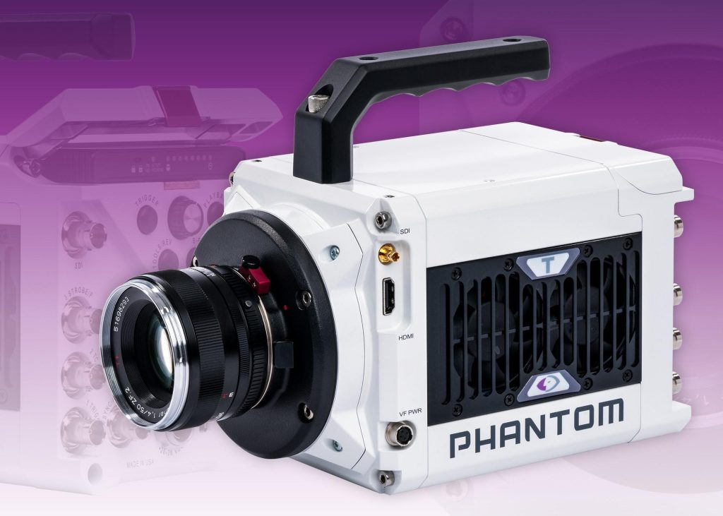

Vision Research—a leading manufacturer of digital high-speed imaging systems — introduces the Phantom T1340, a high-resolution camera that captures images up to 13 Gpx/second, doubling the capabilities of other 4 Megapixel cameras in its class. The 2048 x 1952 low-noise sensor, combined with a compact form factor, are ideal for demanding measurement applications such as object tracking, flow visualization, microscopy and modern imaging techniques, like Digital Image Correlation (DIC). A binned mode is included to provide higher throughput and a sensitivity boost at 1 Megapixel and below.
Workflow features of the T1340, which are ideal for applications in outdoor range environments, include Phantom CineMag V compatibility for an ultra-fast and secure workflow. The CineMag also supports direct recording for long duration events. A 10Gb ethernet option is available for fast file downloads, enabling users to continue shooting with reduced downtime in any environment. The on-camera controls, video outputs and CineMag compatibility enable a standalone operation.
“The Phantom T-Series is our new platform that brings higher throughput, larger RAM capacity and CineMag compatibility to a compact form factor,” says Toni Lucatorto, Product Manager. “This combination extends the possibilities for many industrial high-speed imaging applications.”
Key Specifications of the Phantom T1340 Camera
  • Custom 12-bit CMOS sensor
  • 2048 x 1952 at 3,270 frames per second (fps)
  • 1920 x 1080 at 6,160 fps
  • Maximum frame rate: 113,510 fps at reduced resolution
  • Native ISO: Mono 16,000D (25,000D Binned); Color 4,000D (6,400D Binned) -Available with 36, 72 or 144 GB RAM
  • Compact size: 5 x 5 x 8 inches
