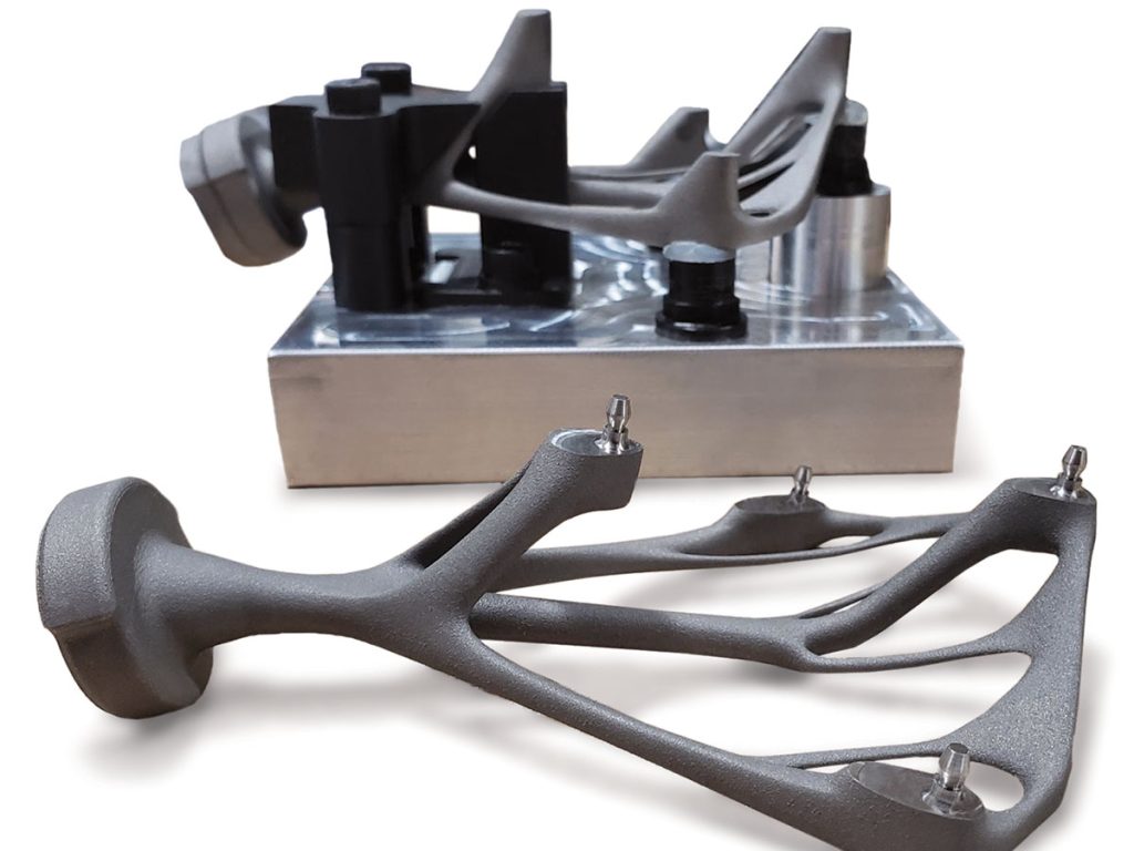

Any part that is at risk for distortion from mechanical clamps or that pose complications in fixture design and tool access are easily and simply held with Blue Photon’s patented grippers and BlueGrip workholding adhesive.
Blue Photon’s workholding grippers are a load bearing, light transmitting fixture component that lock the part in place for machining. Grippers are the foundation of the Blue Photon grip technology with multiple sizes designed to hold small to large size workpieces. The grippers are inserted into a fixture, the workpiece is secured to the grippers with BlueGrip, gel-like adhesive material, and ultraviolent light is transmitted through the core of the gripper for 60 second workholding.
