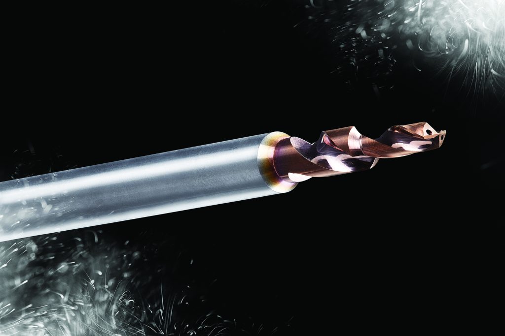

The Sphinx Drinox Pilot Step Drill at 3xd from BIG DAISHOWA features a unique design that the company says delivers up to three times longer tool life, three times higher coolant-through output and three times faster drilling.
December 17, 2025
Available in diameters from 0.70 to 3.00 mm, with intermediate diameters in increments of 0.05 mm, the Sphinx Drinox features coolant-through channels to maximize the coolant output, and the newly developed TiSiN ultra-thin coating that the company says ensures high tool sharpness, improving chip removal and preventing material from sticking. In addition the tool design has a 90° cutting step and tool head, which are based on the geometry of proven high-performance tools and perform exceptionally well in stainless steels, titanium and heat-resistant Ni or Co alloys.
